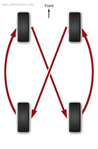

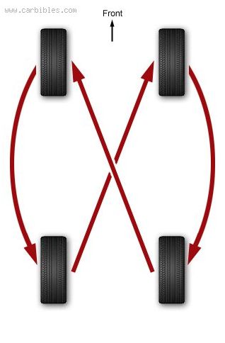

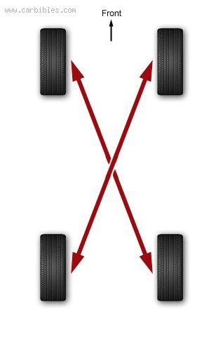

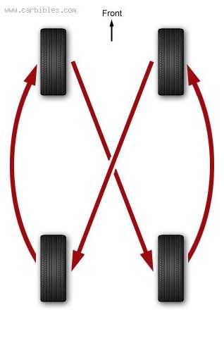

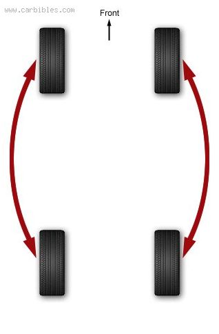

Mesajde ripperu » 22 Apr 2008, 09:24
are careva diagrama de permutare a anvelopelor?
am ajuns la 15.000km si vreu sa schimb fata--spate
ripperu
Mesaje: 642
Membru din: 23 Mai 2007, 12:43
Localitate: San Pedro de la Paz, Region VIII, Bio-Bio
Maşina: Focus Trend Collection, 1.8 TDCi - 115CP, Hatchback, Ocean Blue
VIN: nu_mai_bine_bere_
Re: Exista anvelope pentru partea stanga sau dreapta...?
Mesajde Zanga » 22 Apr 2008, 09:49
1) Any unidirectional tyres
2) 4-wheel drive, non-unidirectional tyres
3) Rear-wheel drive, non unidirectional tyres
4) Front-wheel drive, non-unidirectional tyres
