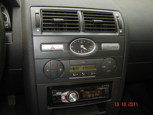

Re: Instalare mp3 - adaptor comenzi volan -
Mesajde TELLGABIX » 23 Dec 2011, 15:21
