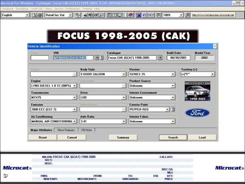

Mesajde Adriancar » 21 Ian 2008, 12:01
@ Valy : WF0AXXGCDA1G15452
Build Date: 30.08.2001
Vehicle Line: Focus
Body Style: 5 Door Saloon
Version: Series 15
Engine: Lynx Diesel 1.8 TC (90PS)
Transmission: 5-Speed Manual - MTX75
Drive: LHD FWD
Axle Ratio: 3.41
Emission: 2000 EEC (EEC 7)
Air Conditioning: Manual Air Conditioning
Territory: (+)"F"
Paint: Pepper Red (met)
Interior Fabric: Swift
Masina este asamblata in Saarlouis/Germania

Mesajde valy » 21 Ian 2008, 19:24
si la km nu scrie nimic .... :lol: mersi oricum adriancar
