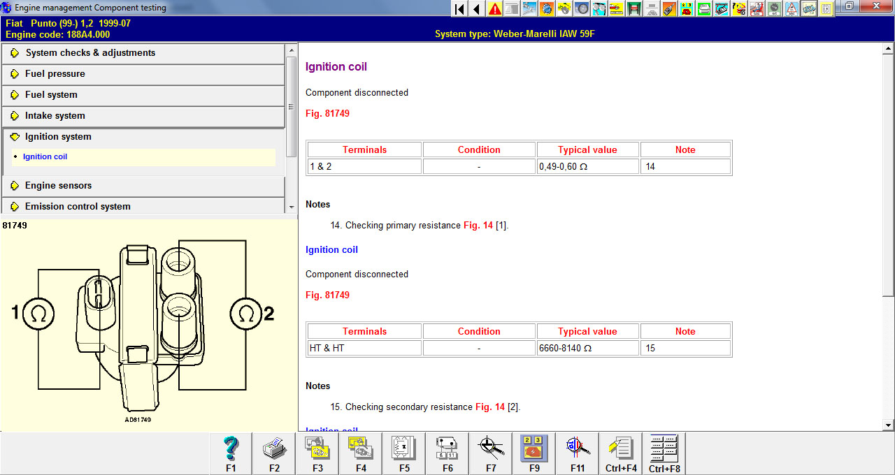

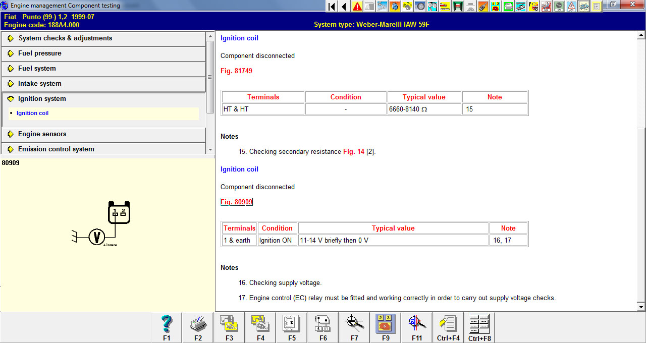

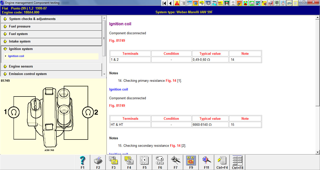

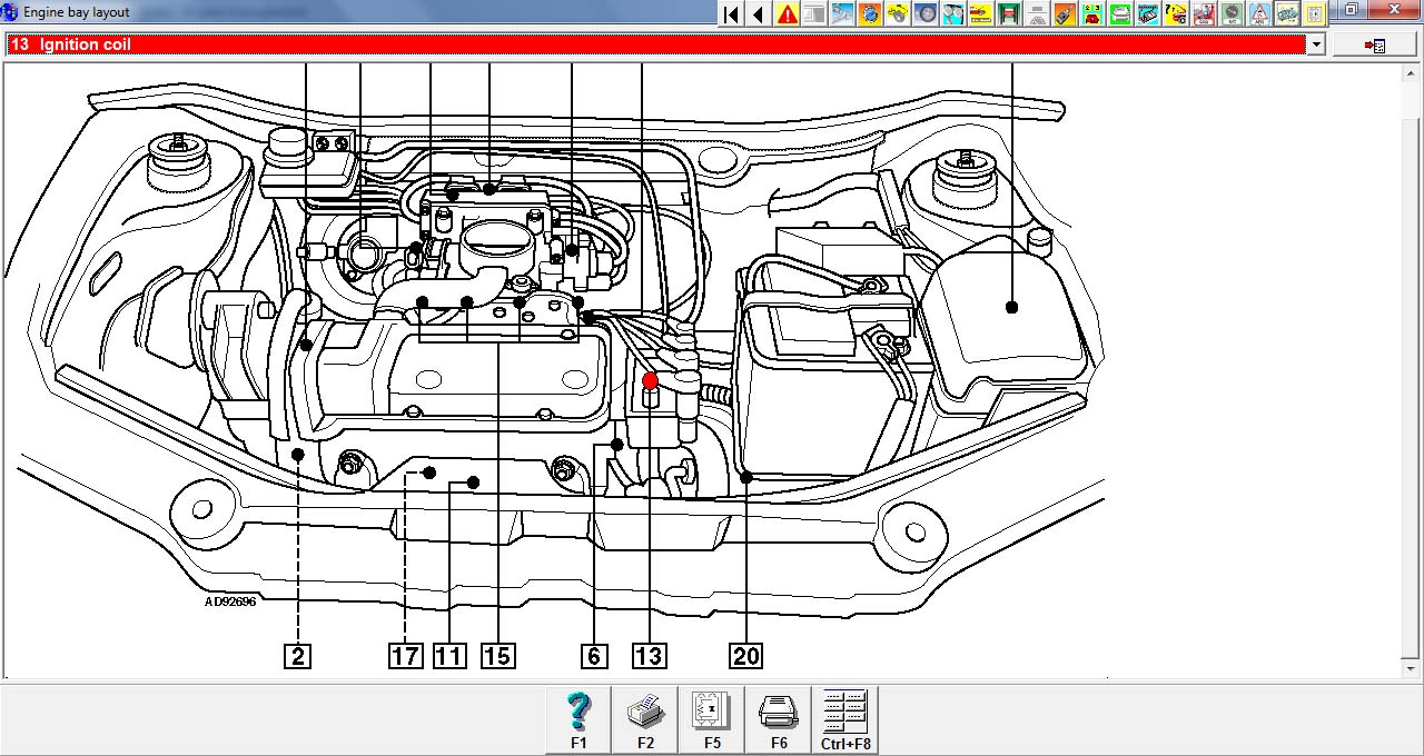

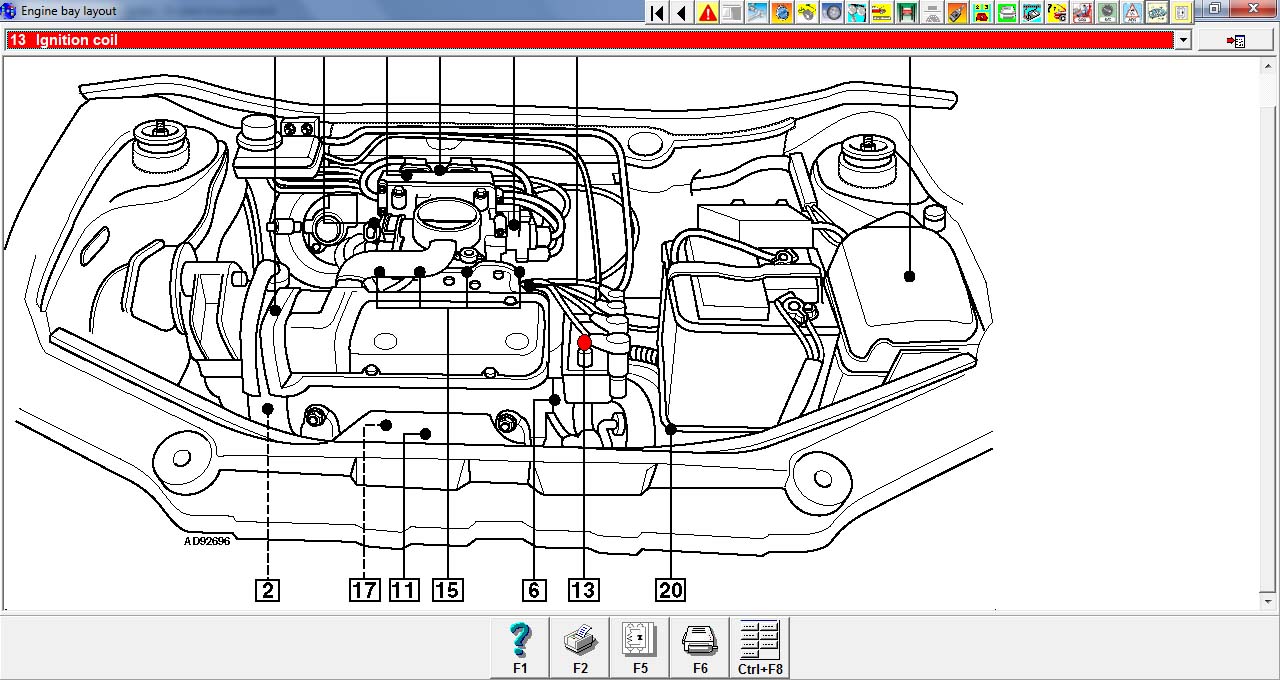

Mesajde addy2002 » 02 Sep 2010, 22:52
cred ca cel mai bine ar fi sa intrebi pe un forum fiat
dar totusi ce gasesc eu este:
code: P0351
Fault location: ignition coil A, primary/secondary - circuit malfunction
Probable cause: wiring, ignition coil, ECM
Localizare:
Procedura de test:
test partea 1
test partea 2
addy2002
Mesaje: 3142
VIN: WF0HXXGAJH5C02432
