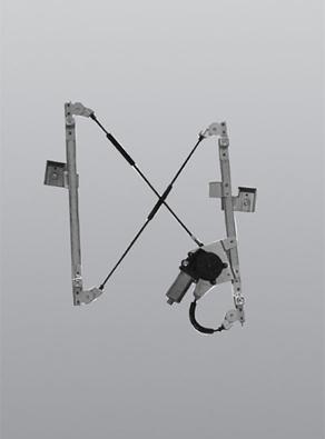

Mesajde PUYACA » 01 Apr 2009, 15:54
0726444372
AM NUMAI PIESE NOI
LA MOTORASUL TAU NU GASESTI DECIT CU SINE CU TOT(MACARA)
EU AM NOUA CU GARANTIE 12 LUNI LA PRETUL DE 483.5 RONI
TI-AM ATASAT SI O POZA
