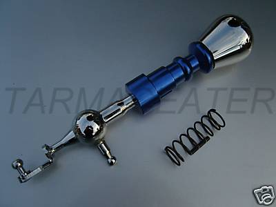

Am tot vazut pe ebay short shifter`s pt focus de diferite modele ,iar din ce am cetit nu toate se potrivesc pentru un anumit model de masina...depinde de cutia de viteze...
M-ar interesa avantaje si dezavantaje..montarii unui astfel de shifter..
So PLS express your self free :D
Multumesc,
PS : Inca ceva haideti sa incercam sa fie un topic constructiv si de folos pt toti ..
FORD FOCUS 2.0 1998 - Apr 2002 with lift up reverse
MONDEO 1998 - 2002
COUGAR 1999-
ORD FOCUS 1.8 and 2.0 from APRIL 2002 to 2005 with manual gear box.
May fit other Fords fitted with the MTX75 gearbox. It will NOT fit 1.4, 1.6 and 1.8 Focus or Escorts as they are fitted with the IB5 gearbox.
