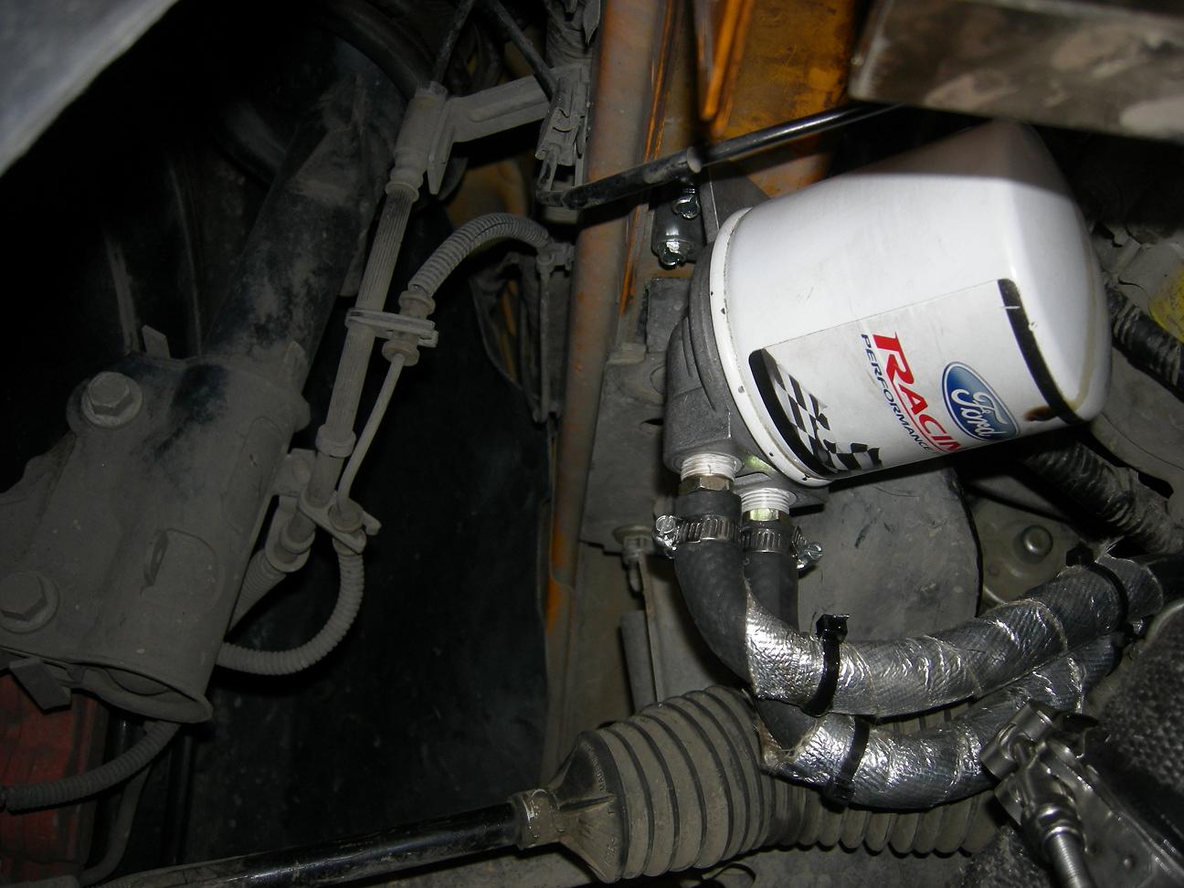

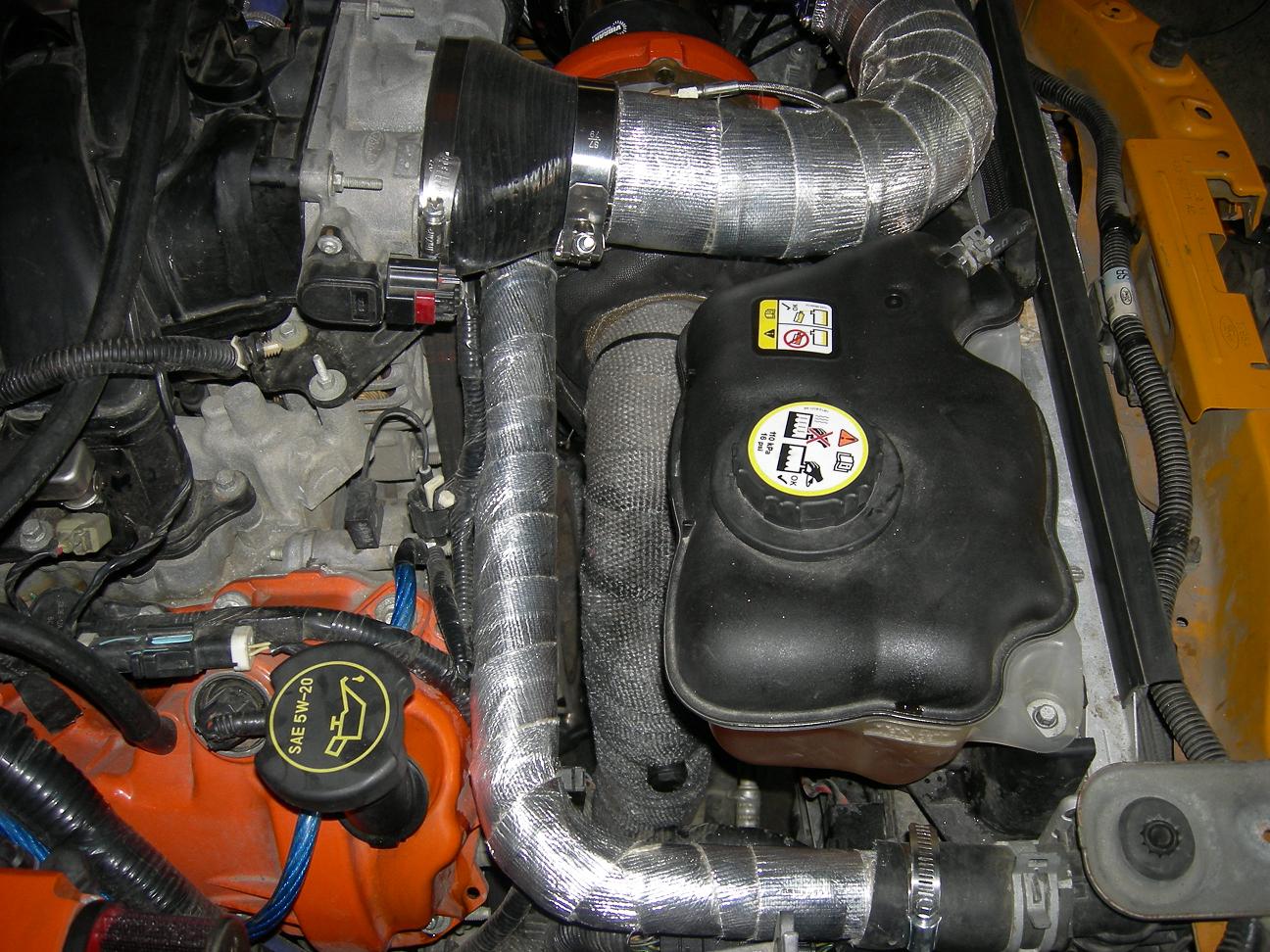

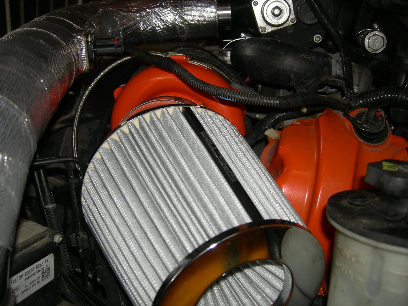

Inca o bucata american muscle:
Short block SC Aluminator 5.4l Ford Racing 8.5:1 CR - complet forjat
Chiulase Edellbrock CNC ported
Garnituri chiulasa Cometic MLS
Prezone chiulasa ARP
Axe turbo + arcuri + limitatori COMP CAMS
Kit relocare filtru ulei Moroso
Kit oil feed + oil return Moroso
Turbo Precision Billet 6768 ( GT4288 )
Husa Turbina Tial

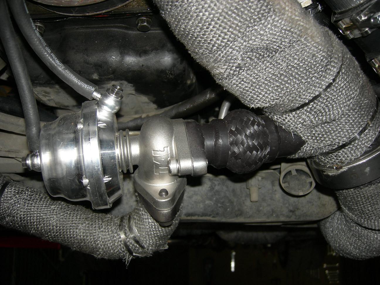

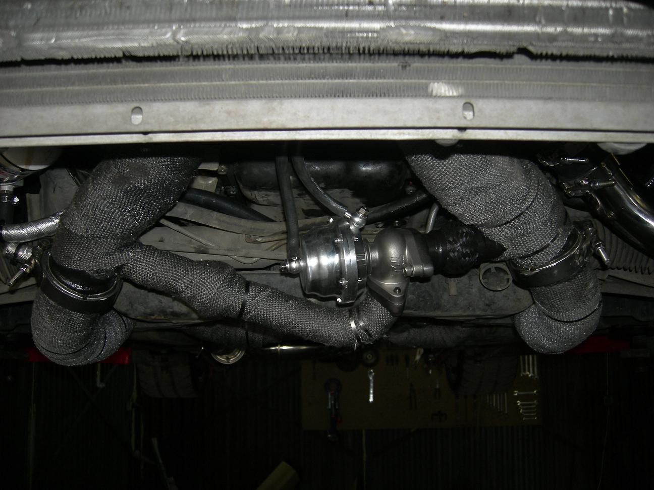

WG Tial 38mm
BOV Tial 50mm
Intercooler Moroso
Injectie cu metanol SNOW
Injectoare Ford Racing 800cc
3 Pompe de benzina Lethal Performance
Debitmetru PMAS HPX
Sensor temperatura relocat FORD RACING
Boost controller Turbosmart Street 2
Traseu evacuare 80mm + traseu intercooler + concept - made by SRZ
Galerii + tevile evacuare + turbina acoperite ceramic - made by SRZ
