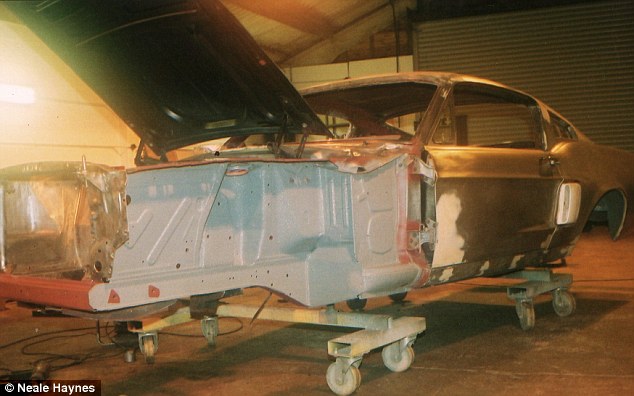

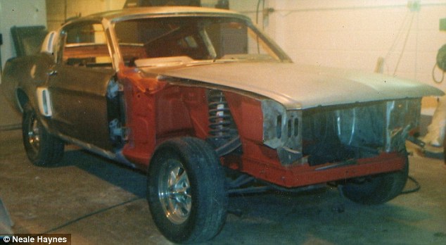

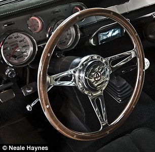

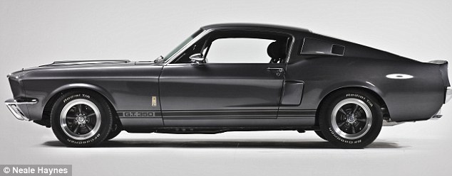

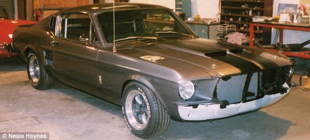

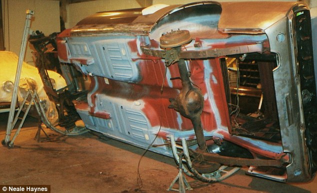

Mesajde bibanu47 » 30 Ian 2010, 17:05
Reconditionarea unui Ford Mustang GT 350,asa zisa ELEONORE:
