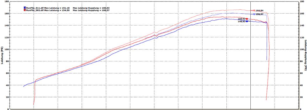

Mesajde Adrian_Rujan » 19 Oct 2011, 08:59
E foarte interesant ce zice pe european-parts despre ea
19% more air flow compared to standard 55mm throttle body.The PCM software will automatically adapt the new throttle body, no modifications required, a simply plug and play modification. Outer diameter remains standard, so you can keep your existing intake tube. Please disconnect battery for installation!
blue Fiesta ST OEM 55mm TB, 100 octane fuel
red: Fiesta ST 60mm TB, 95 octane fuel
both: Code:Red Intake System, full Milltek Sport exhaust, software
DIN: EG
